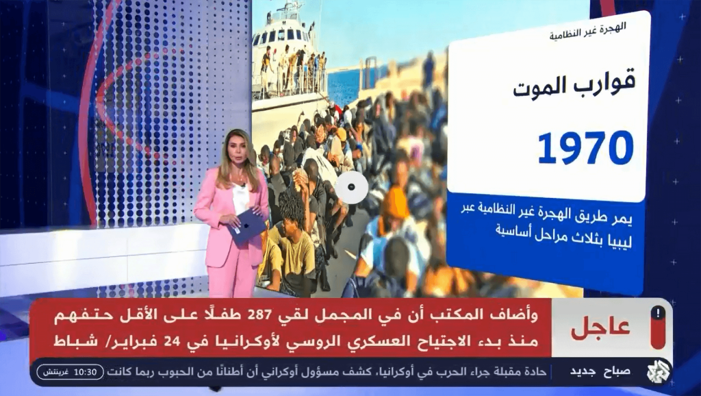

Viz Pilot Edge made it possible for correspondents on the ground to access, search, and use templates just like their colleagues in the main newsroom, to produce from anywhere. “We worked closely with Vizrt to improve the early version of Viz Pilot Edge. They listened to us about what we needed. Now if you look at Vizrt [at Alaraby], it’s completely different – AR, XR, VR, integration with Unreal Engine, all the automated workflows we have with Viz Pilot Edge – data integration, the Viz Arc controls for virtual production. But most importantly – collaboration, ease of use, and support,” emphasizes Husseini.
Alaraby – Viz Pilot Edge powers Alaraby newsroom production
Engaging graphics: Alaraby uses Viz Pilot Edge as the templated graphics solution in its newsroom.
Maha Rezeq, producer of the social media-driven program, Tawasul, agrees, “The thing that’s very distinguishable about Vizrt is the ease and creativity it provides. We use charts, numbers, tweets, Facebook posts, maps, and everything is heavily dependent on templates. It makes the story more visual, and it makes my life easier as a producer, especially during breaking news.”
Viz Pilot Edge’s templated workflows make it easy for journalists to create and publish graphics to complement their stories, anytime and from anywhere. Additionally, with TypeScript (a superset of JavaScript that supports scripting for more sophisticated templates), the designers are able to easily code and create custom templates specific to their needs.
“The best part was Template Builder and TypeScript, which has completely ruled out the need for Custom HTML, so I don’t have to use (Custom) HTML templates for Viz Pilot Edge. We are using TypeScript, combo templates, and Transition Logic. You get all the flexibility that you had in Template Wizard (Viz Pilot – ActiveX) earlier – you can do dropdowns, checkboxes, which is very good,” says senior graphics designer Faisal Roshan.
“Initially, we built our templates into HTML, because we had Arabic text. And normally Arabic letters are quite small for the operators to read. With TypeScript, we were like ‘Oh, great’, it has got all the capabilities we have been looking for, and it’s easy to use for journalists.”
